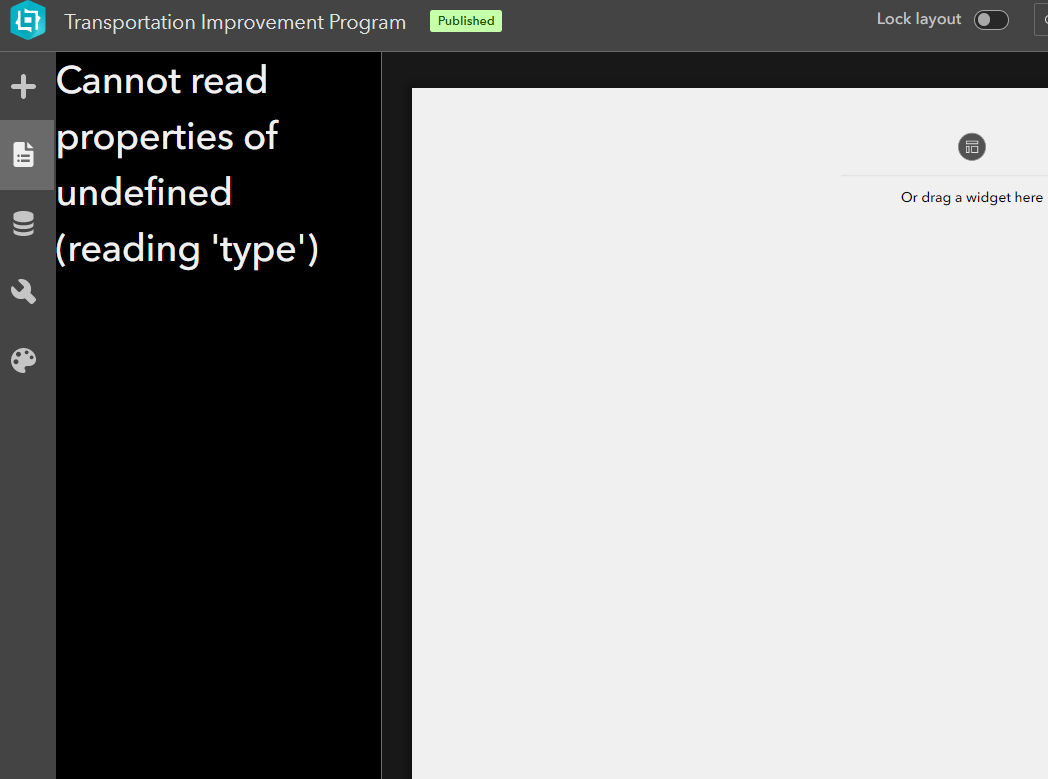

Help! I have been working on this for the last week and I went to complete my home page for the experience today and this happened. I now can't see my pages in the Contents pane, and I can't edit this one with the Contents Pane editor options. I'm freaking out... what do I do? I have a presentation next Wednesday and was hoping to showcase this.

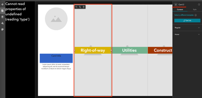

Hello @OLIVIALUNSFORD -
After checking, the widget causing the problem has been identified, but we are not sure what configurations had been done prior to this - it is quite weird and probably needs certain specific pre-steps.
The good news is - there is a way for you to resolve this issue on your end.
1. In the builder canvas, select 'Card 2', and then delete it:
2. Save the app and then refresh the browser. It should look fine now.
All you have to do now is to add another Card widget as a replacement and continue building the app.
Thank you,
Tonghui

TonghuiMing

Here is the experience. I was working on the "Need To Know" Page when this happened. I was going to implement hover cards with descriptions for project phases that the user will see on the second page.
But I literally can't even access the Pages section of ExB to delete or add Pages anymore. I was going to delete this one and just start over because of the error, but there's no way to back track.
