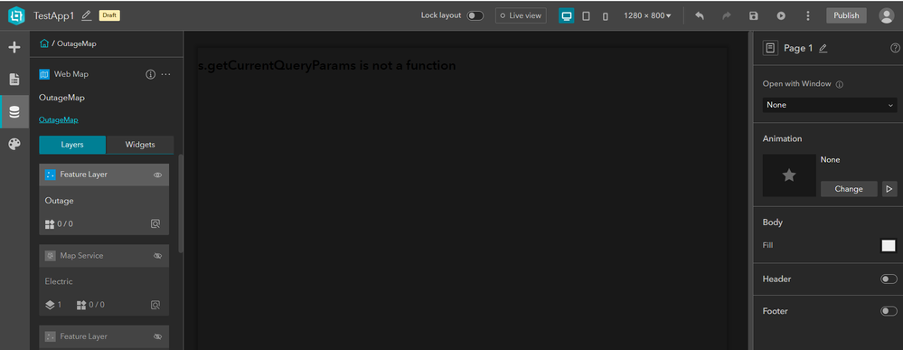

Dear all,
I just started using Experience Builder latest version 1.6.
I connected with my ArcGIS Enterprise Portal account and I am creating one sample application.
I have selected launch pad theme, and added a Webmap from my ArcGIS Portal. After adding webmap , if I try to add any widgets or if I tried to set Map widget style --> I am getting the following error
"s.getCurrentQueryParams is not a function"
For your understanding attaching the error screenshot here.

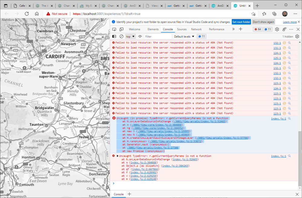

AndrewVentham
Hi @TonghuiMing,
  I don't think we could very easily share our data, but here's a screenshot of the JavaScript error(s). I wonder if it's a subtly different bug, since the minified object name is "r" rather than "s"!?queryparams_error.png

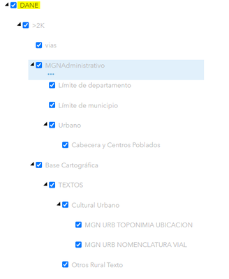

HaitingHuang
For my case, it was caused by an Image Service that contains group layers (actually multi-level group layers). By removing the specific Image Service layer from the web map, the error in the ExB was gone.
