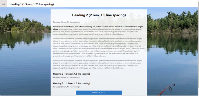

Thankfully, I did have a template created from this app a few months ago that has the original settings. Take note that there is a title (heading 1) and a subtitle for the app in the upper left:

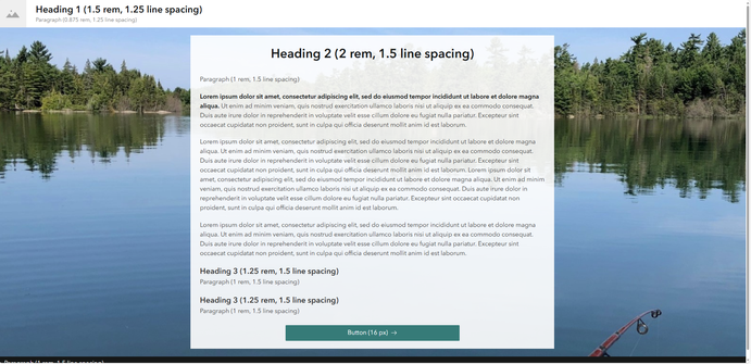

To illustrate what's happening, I've changed the theme to "Ocean," one of the new theme options. As you can see, the bulk of the text (the paragraph-sized text at least) is pretty much the same size visually as it was before. However, the title/heading 1 now takes up so much space that the subtitle underneath it isn't even visible anymore:
In the real app, I didn't realize immediately how much the look of the text had changed, and so I brought in Montserrat font through Google Fonts. Initially, I thought this was the issue, but you can see the overall layout of the text is pretty much the same as the previous screenshot:

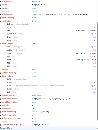

I don't have any web development experience, so in trying to figure out what is happening, I "inspected" heading 1 of the original version, and I see this:

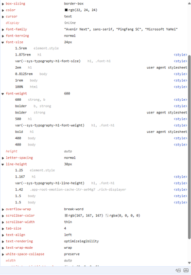

When I inspect the same heading after changing the theme to "Ocean," some of the settings are different:
I don't know what the cause is or if these last two screenshots are all that relevant, but the new themes do not seem to be working in this regard?

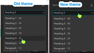

Hi @NicoleJohnson , this is as expected. As in new themes the text font changes even with the same type. Here is a comparison:
The headings font size are different in old and new theme (the number indicates the font size of the text type).
So when you use ocean theme, the heading 1 font is much bigger than in old theme which also affect the old theme. So here are some facts:

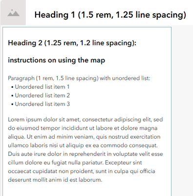

@Wei_Ying, here's a comparison of some text themed the old way:
And the new way--there's now a lot of negative space between the lines despite the font size and line spacing staying the same (at least as far as settings I can access through the builder):
I totally understand warning users that opting for a new theme will make changes to their app. What I didn't expect is that I can't even manually return everything back to how it was. It really seems as if the headings are "locked in" to appearing a certain way. For example, if I choose heading 1 then change the pixel size to 16, there's a ton of negative space above the text, as if it's expecting much larger text to be there:
There's much less negative space (maybe half as much?) when doing this with the old theme options:
