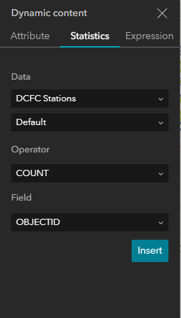

I have an experience builder app set up with a map along with a text box including a count of the features in the map. Is it possible to create an action to filter this count as the map extent changes?
This is how the text box count was created.
Any help is appreciated.

Yes, select the Map Widget first and in the map configuration panel on the right, click the action tab.  Click Add a Trigger.  In the Select Trigger window, click Extent changes and for the Select a target, click Framework.  In the <-Select an action window, click Filter data records, and then select the data/web layer to filter.  I believe your Dynamic Content is correct.  What is the result?
