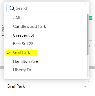

I am using Filter widget in my application.
Currently I can see there is single value selection and based on selection zooming to particular feature.
But I am looking for following 2 functionalities.
1. Allowing user to select multiple values (more than one). As shown in below picture, I am able to select single value. Need to select multiple.

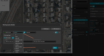

Multiple selections are included in the Filter widget and is configured in the SQL Expression.
Just need to pick the "Is any of" option:
Which will give you checkbox's in the filter list:

Hi RhettZufelt ,
Thank you. Multiple selection is working.

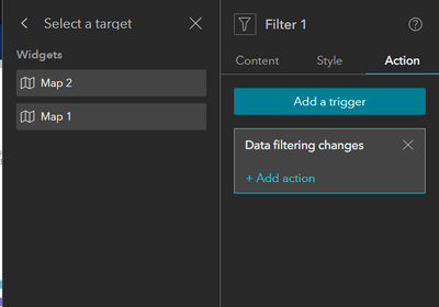

TonghuiMing
Record selection change > Filter Data Records is designed to achieve what you want for the second case. See Experience Builder > Message actions for more details.
Since filtering for the data sources is at the framework level, you need to set the actions inside your target widgets separately, such as Chart, and Table like you mentioned.
Ashok
Dear TonghuiMing,
As I observed, I did not see an option for setting framework level for Filter widget in MessageAction settings.
Please check my Filter widget's Message action setting below.
Note: In my target widgets, I have already set framework level Filter data records has set.
