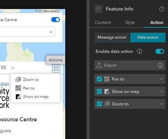

I have a Feature Info widget configured with Data Action enabled (pan to, zoom to, show on map). This works fine when I view the published app.

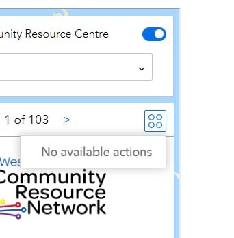

However, when I embed this Experience app in an iFrame (see https://jsfiddle.net/1b04hy6u/) The Actions button displays "No available actions":
Anyone know why this might be?

Hi @JasonBatory ,
Thank you for bringing this issue to our attention. It is a known bug that will be included in the next release.
To resolve the issue in the current release, you can enable the custom layout for small and medium screen devices.

Thank you Shengdi for that information.
Enabling custom layouts has fixed the issue.
