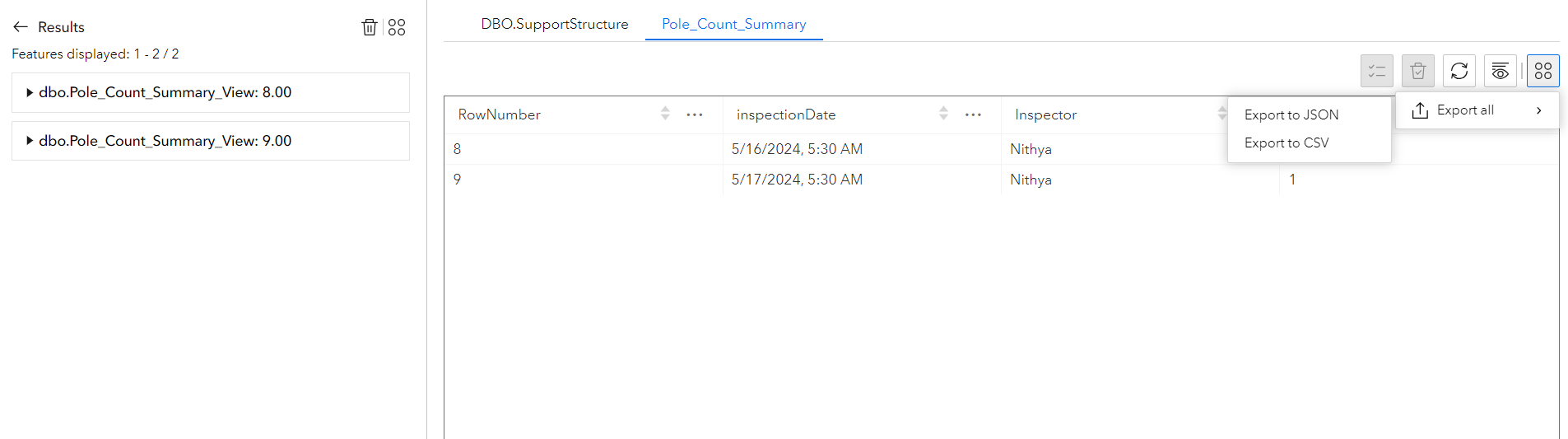

I am getting the results in table widget. But when I tried to Action-->Exportall-->Export to CSV/JSON , there is nothing downloading. And it's happening only for the Feature table/view,  but when you set the sheet result as output of Feature Layer from Query widget, the Export is working fine.
Please help on this.
Attaching below screenshot for more idea.
In the above screenshot , Support structure is Feature Layer (export is working in table widget), Pole_Count_Summary is a Table (export is not working)

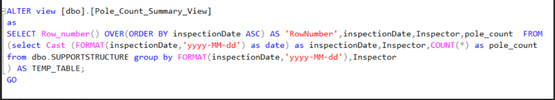

And sorry for the misunderstanding. In the above details, the table I mentioned is actually a View created from a feature layer. But however after published, it will treat as a Table in Map service if I am not wrong. Please find the query for my View below.

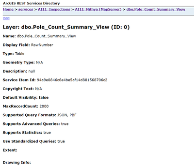

So when I am trying to export the results of this view from Table widget, its not working. Please find map service details of the View below..

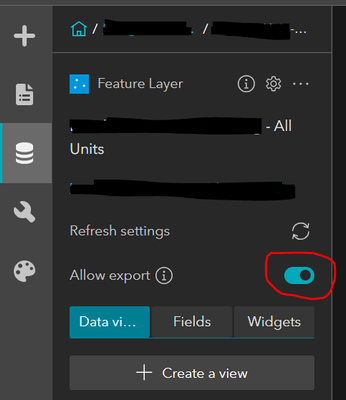

did you make sure that in the EB datasource settings, you enabled data export for this source your using for the table widget?
