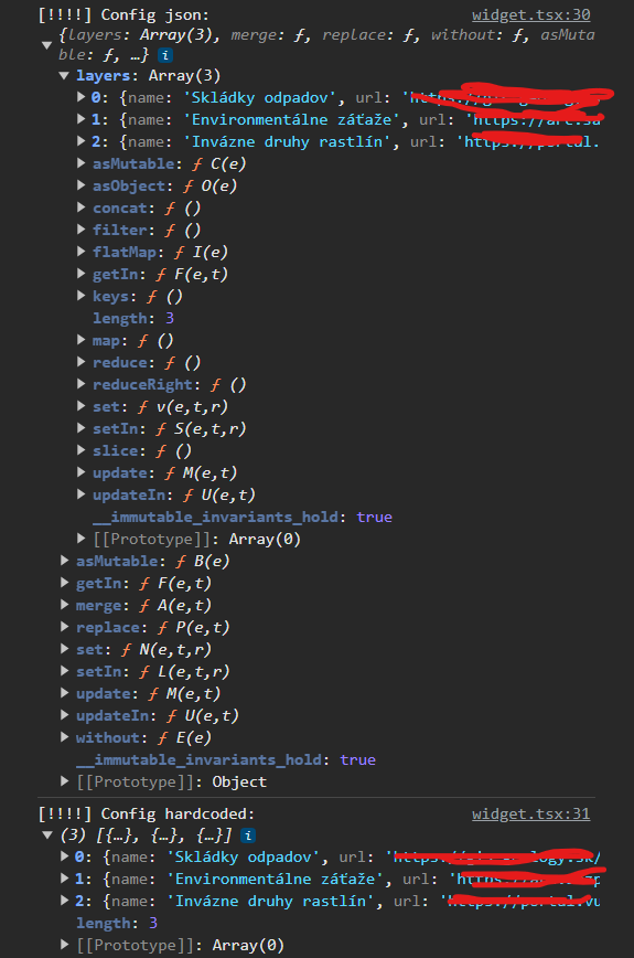

Error Message:
[esri.WebMap] #add() The item being added is not a Layer or a Promise that resolves to a Layer.
This error occurs at the line where I try to add layers to the map:
layers.forEach(({ layer }) => jmv.view.map.add(layer));
Extra:
Here is initial layers for the working sample:
[initial layers for working sample](@https://i.sstatic.net/8ABzS7TK.png)
And for the non-working:
[initial layers for non working sample](@https://i.sstatic.net/XIKFGj3c.png)

Since I typecasted it into ImmutableObject, it added a bunch of other properties that obscured it and I suppose it wasn't identified as a layer, so I parsed it again!

I can only call initialLayers inside map function, but there is no layer property.
Extra:
