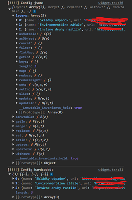

Here is initial layers for the working sample:
[initial layers for working sample](@https://i.sstatic.net/8ABzS7TK.png)
And for the non-working:
[initial layers for non working sample](@https://i.sstatic.net/XIKFGj3c.png)

Edit:
Config from both working and non-working samples:

Since I typecasted it into ImmutableObject, it added a bunch of other properties that obscured it and I suppose it wasn't identified as a layer, so I parsed it again!
