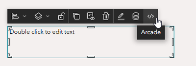

You can insert Arcade expressions into the text widget. Click the Arcade button on the text toolbar to open the Arcade editor.

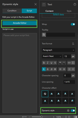

Select data in the Text widget, and then you can see "Dynamic style". You can use Acade Editor.

Dynamic styling is misleading as dynamic styling only controls background color & text properties like size, bold, italic. However, it does not change the text content itself as it can’t take a long string with • characters and magically convert them into HTML <ul><li> bullets.
Unless you have an example where this has been done that you can share with us so we can learn how its done. All the examples out there that I have come across are only changing text color and size with dynamic styling.

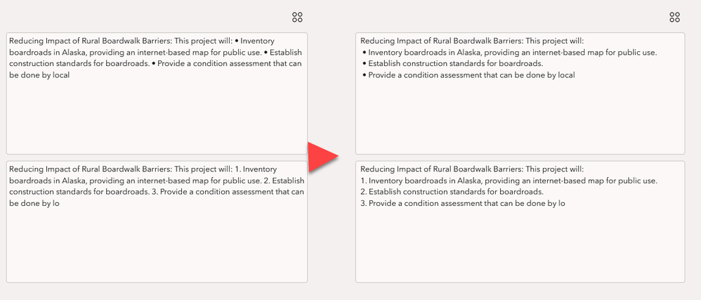

The easiest way to do this would be to simply create faux bullet points in your Arcade using the replace() function.
// Documentation: https://arcg.is/18ejKn3
// field with the bullet formatting
var start = $feature.issue_type_other
var end = Replace(start, '• ', '<br>  • ')
return {
  value: end,
  text: {
    // size: 14,
    // color: 'rgb(0, 0, 255)',
    // bold: true,
    // italic: false,
    // underline: false,
    // strike: false
Numbered list items make it a bit trickier, you will need to chain a series of replace statement together and account for each possible number used.
var bull = Replace(start, '• ', '<br>  • ')
// chain replacement statements until all possible numbers are accounted for
var num1 = Replace(bull, '1. ', '<br> 1. ')
var num2 = Replace(num1, '2. ', '<br> 2. ')
var num3 = Replace(num2, '3. ', '<br> 3. ')
var num4 = Replace(num3, '4. ', '<br> 4. ')
var end = Replace(num4, '5. ', '<br> 5. ')
return {
  value: end,
  text: {
    // size: 14,
    // bold: true,
    // italic: false,
    // strike: false
- Jen

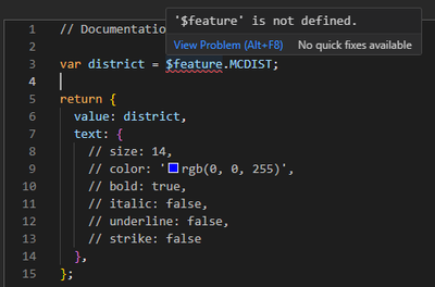

Your example and the documentation show the use of $feature to access the data, but I'm trying to write a dynamic text expression and the builder doesn't seem to recognize that as a valid way to get the data.
JenniferAcunto
Try $dataset instead of $feature
