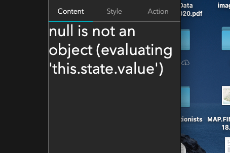

Seems like side bars in experience builder are an invitation for erratic behavior inside of the editor.
Any list items inside a sidebar behave inconsistently and Im often getting Null Object statements in the Content panel both inside and out side of sidebars.
Am I missing something or is this an issue?

Im actually finding the issues are not necessarily related just to side bars.  Messing with the Maximum numbers can get the list widget tangled into the Null object issue. Set it to 0 and you should see what I mean. I am also finding the behavior of the list widget to be inconsistent between the Live view and once published. The lists ability to change what portion of the list is visible related to filtering by map selection is behaving in a way that doesn't make much sense to me.
DanMoses1
And now I am finding that if I do anything unexpected with the sizes of the list box or the text box inside of it, it breaks. I add a header and footer and it crashes the list. Ive tried Safari, Chrome and Firefox. The only way Ive found to get up and running again is to delete the list entirely and make a new one. Thoughts?
DanMoses1
I think I found the problem.  Padding for list can not be set to 0. That crashes it.

Hi Dan,
I was able to reproduce both issues.  I will get these logged.  I am curious to know why did you select 0 for maximum items to be returned, was there some time of workflow you were trying to achieve? The reason why I am asking is the list preloads data with a query so I am trying to understand if there is some workflow we missed.
