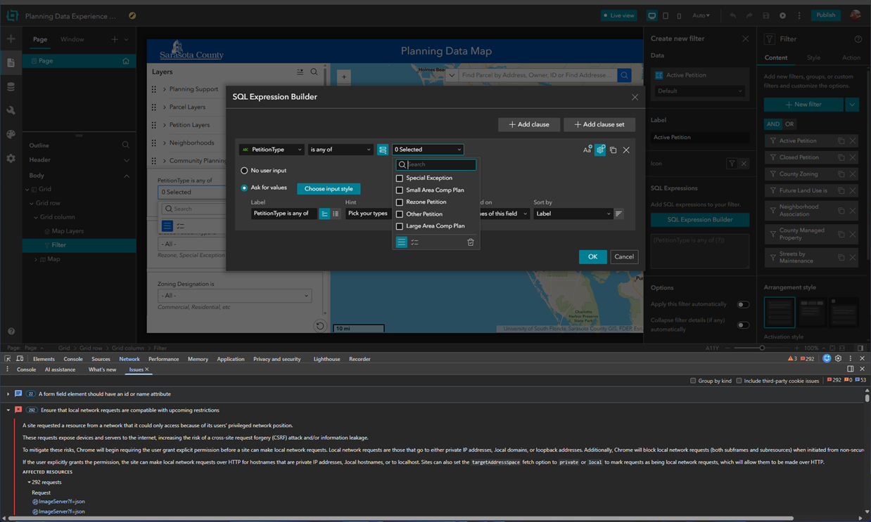

In my case, the Filter type 'Is any of' will build in the Filter expression builder config, but the multi-value pick list control is then not displayed in the widget itself:
And then here in form element selector, no choices appear:
I don't think this is a new issue.  I can tell you for this experience all of the layers from my webmap data source are from enterprise 12.0  portal hosted distributed collaboration feature layers.
