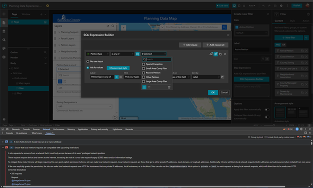

In my case, the Filter type 'Is any of' will build in the Filter expression builder config, but the multi-value pick list control is then not displayed in the widget itself:
And then here in form element selector, no choices appear:
I don't think this is a new issue.  I can tell you for this experience all of the layers from my webmap data source are from enterprise 12.0  portal hosted distributed collaboration feature layers.

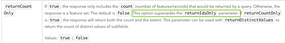

Per our colleagues' investigation, this issue lies in a bug on the service side of this special case. Here are the details (note that usually, or mostly, the "No data" issue from the Filter unique list has something to do with the service bug or limitations, but it is case by case - between many properties, so it is a bit different from the other post, I would say):
When querying count, the JS API layer adds `{ returnIdsOnly: true, returnCountOnly: true }` to the query parameters. Based on the Rest API doc (https://developers.arcgis.com/rest/services-reference/enterprise/query-feature-service-layer/ ), the `returnCountOnly` should supersede the `returnIdsOnly` parameter. But the service doesn't follow the rule and returns an array of object IDs.
See the actual result that conflicts the expected behavior https://ags3.scgov.net/server/rest/services/Hosted/PetitionActive/FeatureServer/0/query?f=json&retur...
Maybe you could reach out in their channel? Sorry for the inconvenience.

@TonghuiMing - I would reach out if I knew what I was asking for, but I don't.  Are you telling me that in this portion of the get request:
.../0/query?f=json&returnIdsOnly=true&returnCountOnly=true&outFields=petitiontype&returnDistinctValues=true&...
should be:
.../0/query?f=json&returnCountOnly=true&returnIdsOnly=true&outFields=petitiontype&returnDistinctValues=true&...
If so, it did not seem to matter when I just physically changed the order in the request and pasted it into the browser.  The json return looks the same.
I don't understand how the Filters' SQL query configuration can get a correct syntax REST 'read' and display the proper choice list, but somehow when presented in the UI form the list disappears?
I'm sorry but I don't get it, and I cannot be the only person that creates their experiences with enterprise hosted feature layers sourced from a distributed collaboration.
How can that be a server side issue?
