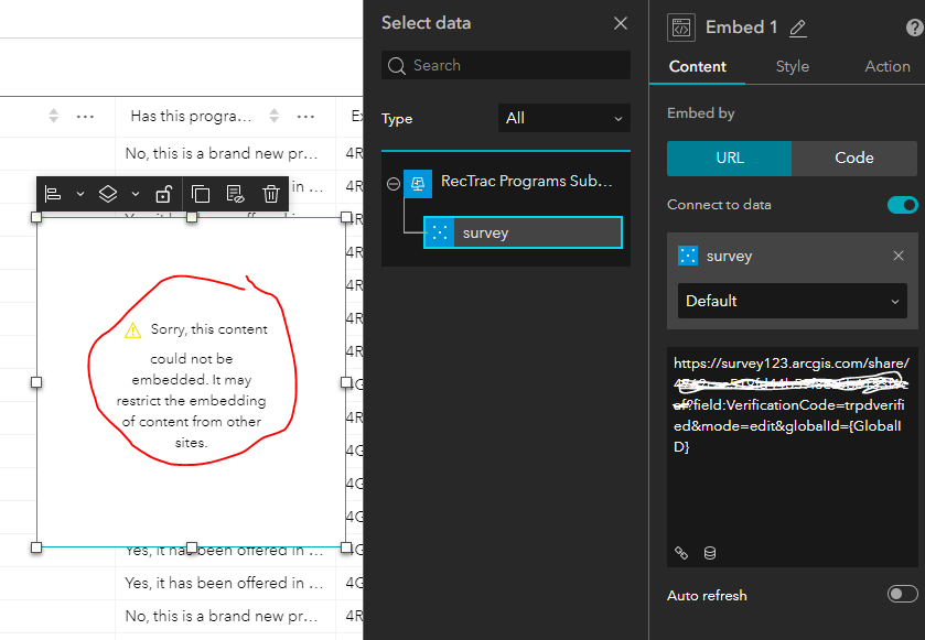

ChesapeakeBayFoundation
Trying to do this as well for the first time. I need to use a list to select a record to edit (instead of selecting a feature from the map). Which is why I'm using the embed widget instead of the survey widget - It appears that I have to use the map to select a feature to edit when using the survey widget.
But as soon as I connect to the data and add the globalID parameter, the survey does not show up and all you see in the frame is the URL. If I don't connect to the data, the survey does show up. The correct GlobalID does appear in the URL though. So strange. Is this related to the issue described above?

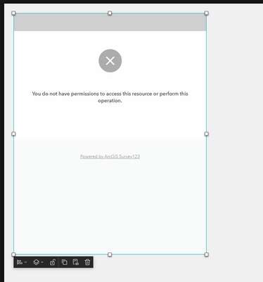

anonymous55
it was working last week just simply add url to embed widget but right now I am getting this error. it just works on public surveys 😞
