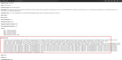

After some more poking I've realized this may be attributable to some invisible list present within AGOL. Whilst no list or domain was ever present for the permit field, AGOL seems to have generated a list of unique values to be used as the values for the permit field. I am now under the impression that this is the source of the problem, though I'm not sure how to go about resolving this.
From the screenshots below, one can see how no list is apparently present in the data tab of AGOL, but the table indicates a predefined list of options in the visualization tab. This behavior is also present in the edit feature of map viewer, where map viewer seems to be pulling predefined values for the field that are not otherwise evident.

The drawing info in the rest service is incorrect, still representing Family Graduate Housing and excluding Fox. I have been wholly unable to get this drawing info to update, however. Do I need to utilize the REST API to implement this? I've admittedly began working on a replacement dataset, as this has proved more trouble than is worth at this point, and I can't find good documentation online regarding this.

I think you just have to republish the service, in ArcPro or something.
JoshBerna
Yah that sounds like its going to be the case. Oh well, thanks for your help @DanCopKac.
