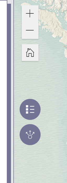

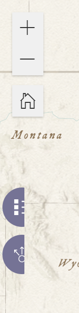

Hi all, In Experience Builder, the widget controller is only partially visible on resizing of the window when viewing live. Is there a way to fix this? Is there a way to cluster it or clamp it to the Home and extent change built-in widgets above it?
Full screen view, followed by when the screen size changes:

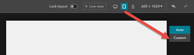

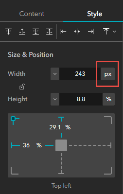

Hi @RaenaDeMaris ,
By default, widget controllers use % as the size unit, so if you resize the window, the width of the widget controller will become smaller.
One way is to change the width unit from % to px in the widget style settings.
Another way is to customize the layout of medium and small screen sizes.
Regards,
Shengdi
