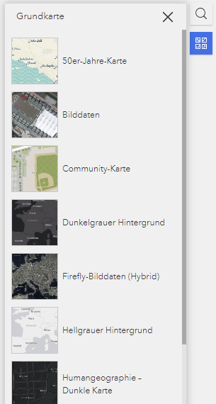

When I publish a public-available Experience from ExB-Developer, our EnterprisePortal organization basemaps do not appear. Instead the Esri default basemaps are listed in the map-basemapgallery-widget.
The organization's basemap/gallery group is set to public, as is all the content/services it contains. Our Enterprise Portal is NOT accessible anonymously. Enabling the "anonymous access" in the org-settings would solve the problem (tested, org. basemaps appear) but due to security reasons we are not allowed to do so.

@AndreasEugster This is the expected behavior with "anonymous portal access disabled".

Thanks for the reply ! In the meantime we got the "standalone basemap widget" which can be used as a workaround / solution for our usecase since you can configure specific basemaps from portal (in our case the org-default-basemap-group and select all listed basemaps). But that only works if you are not required to use the "on-map-basemap-widget".
