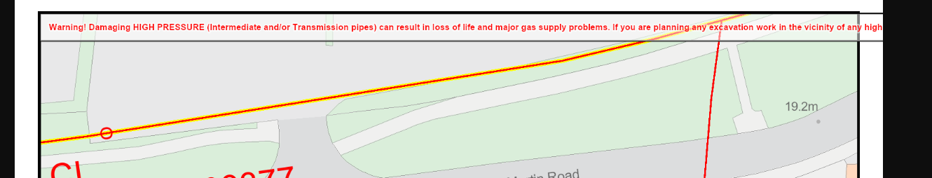

Hello,

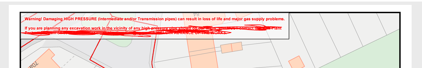

I am testing new Print widget and I require a customTextElement to be displayed. Previously I used the custom print widget by RobertScheitlin__GISP  which works great but our customer might want to have this new "preview extents" functionality so seeing if we can move to the new Print widget.

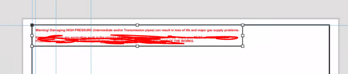

However, there seems to be a bug related to the customTextElement, it does not honour the configuration in the Print layout file (ArcGIS Pro) and displays everything in one line.
Custom Text Element in ArcGIS Pro layout:
Print out from the custom print widget in 1.8v of Exb Dev with modification to output customTextElement, works fine:
Print out from the the new Print widget in 1.9v of Exb Dev, all in one line:
Edit: both Print Widgets configured to use the same custom Printing Service which references the above mentioned ArcGIS Pro layout and the service is published to ArcGIS Enterprise 10.9.1 and configured as a default print service in the Portal settings.
Seems to be a bug to me?

SerjStol
Just to follow up: this bug has disappeared when I republished the print service and shared from fresh to the Portal. I did this after updating ArcGIS Pro 2.9.3 to 3.0. So I am not really sure what exactly caused this, but customTextElement now displays correctly.
