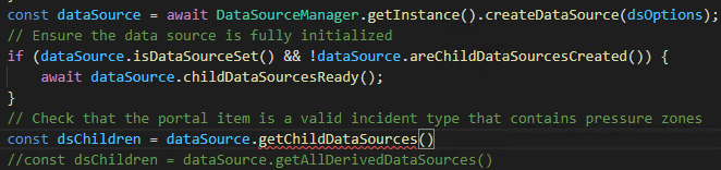

Hello dear mappers,
In a process of updating my custom widget from 1.14 exb dev version to 1.17 due to some breaking changes that make it not work in enterprise 11.5.
Seems like getChildDataSources() property of DataSource object is no longer available? I tried getAllDerivedDataSources()  and getAllLocalDataSources() but they all return empty array.
P.S. Documentation still references getChildDataSources() but its no longer part of the API. Data sources | ArcGIS Experience Builder | Esri Developer
SerjStol
Update: it seems to be still working...  Declaring DataSource as FeatureServiceDataSource gets rid of the TS error as it gains access to child properties
