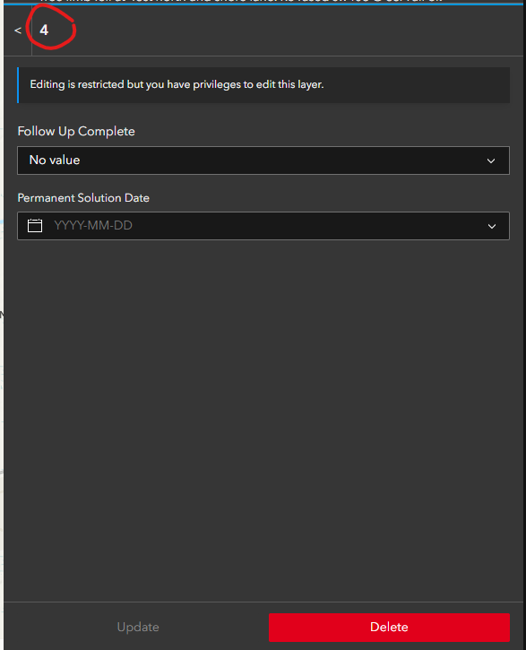

Question about formatting/settings for the Editor widget:
I've built a simple ExB app to allow non-tech savvy team members to easily update a subset of attribute values.
Is there a way to change the identifier circled below?
I have access to ArcGIS Pro if that helps. Hoping this can be done without having to delve into ExB Dev.
bbollin
Hi @wdigis, I think setting a display field on the data using ArcGIS Pro will work. It's using the objectID as the default 😊
wdigis
I have the display field set up and it works for the other widgets. Interestingly enough, it also works correctly when using the "Interact with a Map widget" option.
The Editor widget using the "Attribute only" option is the only instance where it shows the objectID for some reason...
AlixVezina
@wdigis There are some limitations remaining around this in Experience Builder that the team is working on resolving.
