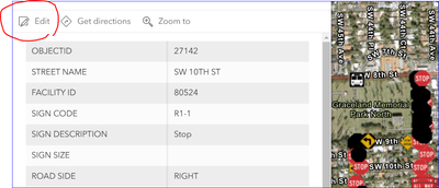

The Edit option from Map Viewer no inheriting in Experience.  Is there any way to make it?

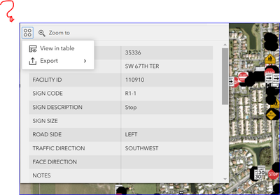

Experience Builder does not support directly editing in a popup. If you add an Edit Widget, selecting a feature on the map should make it selected for editing in the widget.
