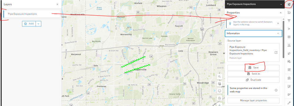

2. If you are connecting the Edit widget directly to the layer itself, you should go to Map Viewer, and from that layer's properties, you'll want to hit Save. This will save, against the feature layer itself, any changes you've made to this layer from within the web map (such as symbology and the smart form).

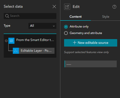

This is what I am seeing:

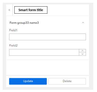

And this is what I wish to see.
