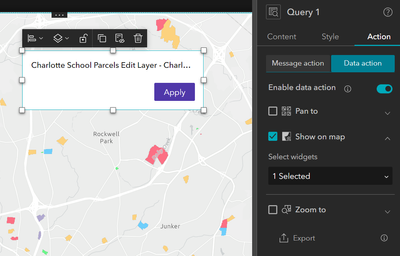

@hijivir Have you tried the Data action > Show on map feature (Data action for ExB ) for your Query widget? It is designed to highlight features of your query results on the map for display purposes.
I am getting a little confused about the query & map structure you have. You mentioned it is shapefile, but I assume you added the data into ExB as a Web Map, and prior to that it should have been published as a feature layer or other acceptable data format? If so, then there should not be any different from using a feature layer directly.
