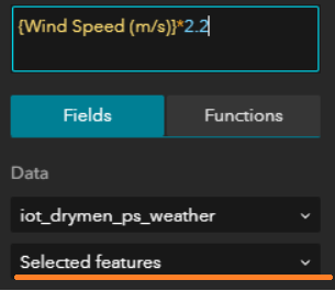

{Wind Speed (m/s)}*2.2
All I get, when inserting the expression is the name of the expression.
I am not sure what your app looks like, but to make the expression you configured work, you will need to select a feature so that the widget/app would know which data record to convert by the expression you set.
Notice that in the setting it says "Selected features" - I assume that you use this expression with either a Map, a List, or a Feature Info, etc. Try click on the features, and it will show.

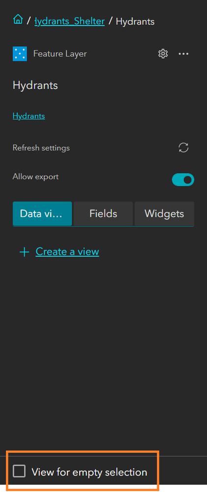

If you want to set the expression to show even if there is no selection made, go to the data panel of this one that is being used, and check the "Empty selection" option, or even go in and configure it. It allows you to customize what you want the connected section to show if no selection is made:
