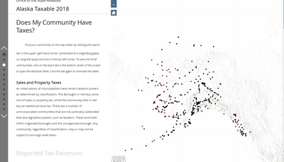

The application looks great and a lot of effort has been put into this. However, this application is not without error either. When I open all the pages and load all the maps, it works fine (except for a layer missing error, but this error can be ignored). But when I go back to the first or second map, the basemap has disappeared:
Only the elevation is still visible. I reproduced this on two different laptops and both in Edge and Chrome. Zooming or panning on the map doesn't help, I cannot get the basemap visible anymore.
On my old laptop, only the last two maps show the basemap after  a while. On my new laptop the last 5 maps still have basemap.
My laptops should be able to run this without error:
-AMD ryzen pro 4750H 8Core CPU, 32 GB RAM
-Intel Core i5 2Core CPU , 16GB RAM
Based on this, I think there is a limit of 10 maps in one page (storymap, Experience). If more maps are needed, the page needs to be refreshed by navigating to another page. This can be achieved by making multiple sites / experiences or storymaps and creating hyperlinks between them. Navigating from one to another will force the browser to release the resources used by the maps and apps on the first page and make them available to the next page, maps and apps. Downside will be that navigating back and forth will reset the state of the map or the app and users will have to wait a few seconds before the map or app is reloaded.
