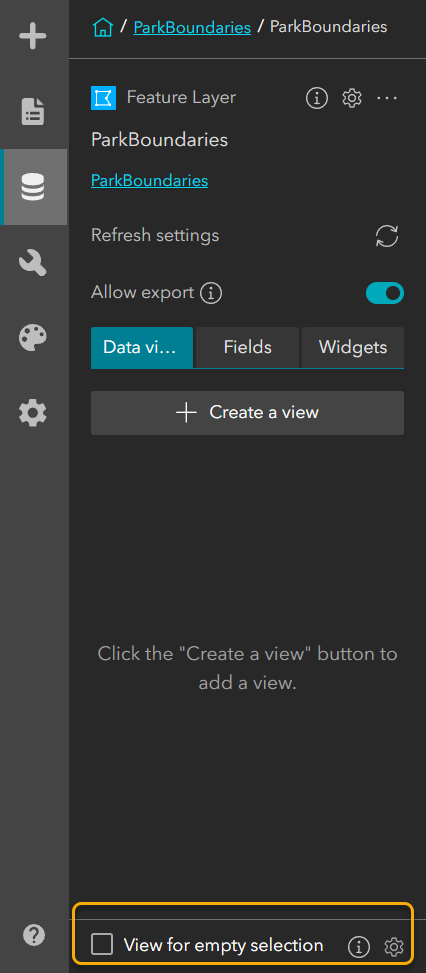

Hi @ColeDevine, have you tried this option? In the data source setting panel, there is an option "view for selection" so you can point to a specific feature's attachment (with a filtering property to control inside the gear icon if checked), if what you want to show is from a certain feature of your data.
If no filters are configured, it will be the first feature by default.
Or is it a static image you want to upload to serve as the 'empty image'?

TonghuiMing
You can add a data cell for the empty selection, say ID=N, then upload the desired image as its attachment. In this settings, try filter using ID=N, then you will see the attached default image displayed with no selection made.
