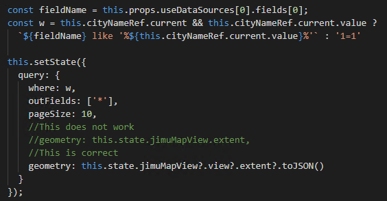

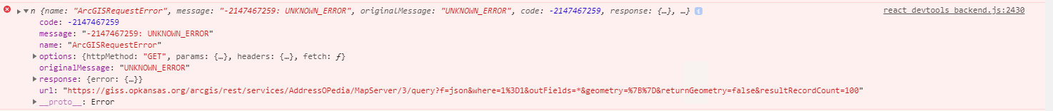

While using the sample widget named feature-layer (https://developers.arcgis.com/experience-builder/sample-code/widgets/feature-layer-class/) I notice that FeatureLayerQueryParams has a geometry property.  I have been importing JSAPI modules to do spatial queries and I thought I would switch to DataSourceComponent instead.  I tried setting the property to an envelope, but it didn't work.  The geometry parameter in the URL to the REST endpoint looked, like this:
geometry=%7B%7D
instead of this:
geometry=%7Bxmin%3A+2254552%2C+ymin%3A+250692%2C+xmax%3A+2254562%2C+ymax%3A+250702%7D
Is it possible to use DataSourceComponent for spatial queries?  Is there some other component I should be using?
See:
FeatureLayerQueryParams Documentation
DaveFullerton
With help from @ShawnGoulet, the answer is to convert to JSON to set the extent:
geometry: this.state.jimuMapView?.view?.extent?.toJSON()
