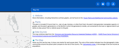

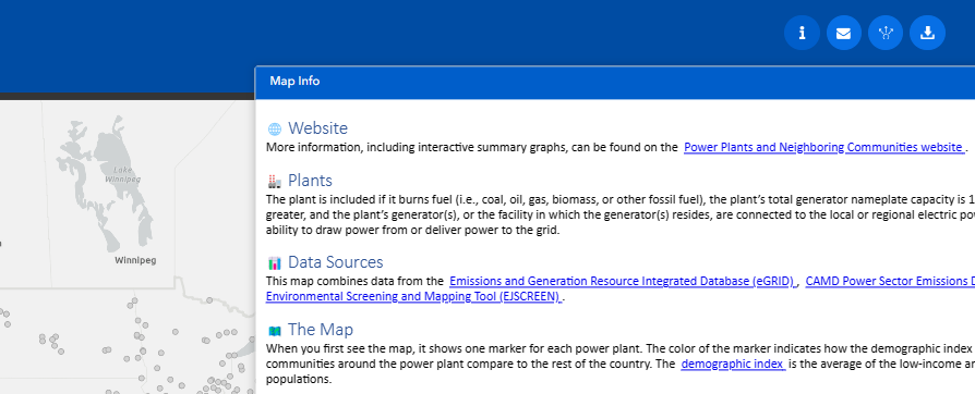

Hello, I found this application on the ESRI gallery and I am trying to something similar to their map info widget. They have images in line with the text like "website". The widget also scrolls.
How do I:
1. Have images and text nicely beside each other that stay in place regardless of screen size. Is this using the px versus % ?
2. Make the whole widget scrollable.
Since you cannot add text to an image widget, or an image to a text widget, I am guessing they put text and images into a card widget. But I cant figure out how they got them to scroll together.

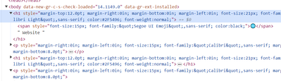

The sample app uses an Embed widget (Embed by Code):

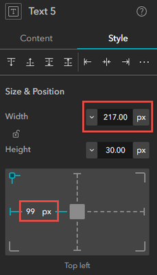

4. For the image and text widgets in the card, use px for both position and width

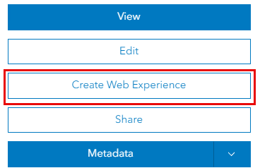

I created a sample template to explain the settings: https://www.arcgis.com/home/item.html?id=b9f0018f65424e27827a059595083da9
Once logged in, you should see the “Create Web Experience” button:
You can then see the details of the settings I used.
Please let me know if you have trouble accessing this template.
