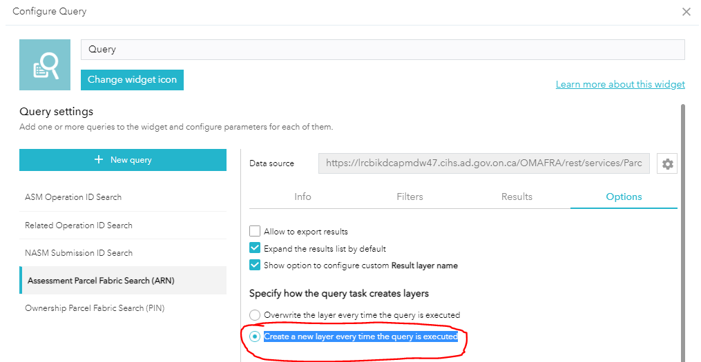

When setting up the the Query widget in the Web App Builder (WAB) I was able to add the query results to the layer list that my users could then toggle on and off.  Does this functionality exist in the Experience Builder (EB)?
I am able to configure the Query widget to add the selection results as a graphic to the map but it unfortunately does not appear in the Layer List.  Is this something that I can do in EB or if not, is this in any future plans for EB?

Layer list shows layers not graphics. Create a feature layer and then add the graphic. It will then show the layer. This can be done with custom script.

Thanks for your response but I don't think it's feasible to create a new feature service every time one of my users makes a query.  All I'm asking for is the same functionality that already existing in the WAB.  In the WAB there was a setting that created a temporary query results service that was stored in the layer list and once the user closed their app / session the query results service disappeared.
I'm not asking for Esri to create something new, just give us what already existed before.
