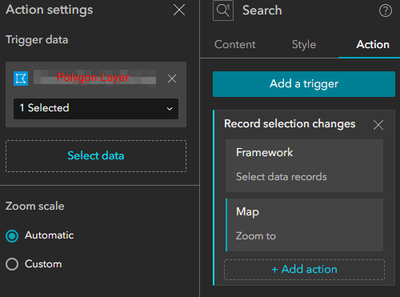

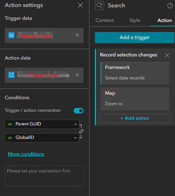

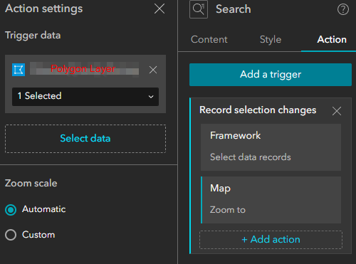

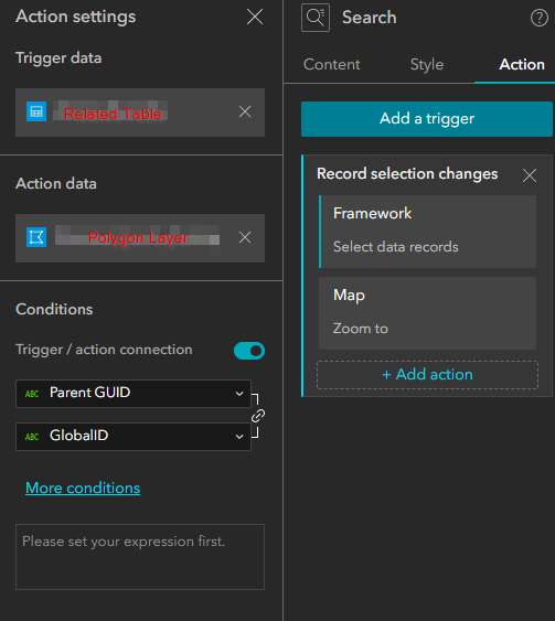

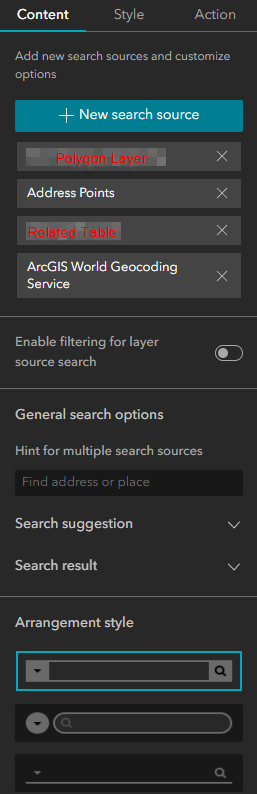

Unfortunately, I can only get two-thirds of the way there. I have gotten the search configured to use the table as a source. I have an action configured to select the related polygon of the selected table entry that was selected via the search bar, but unfortunately, I can't get it to zoom to the selected polygon, despite having a map trigger set up to zoom to that layer. Here are the settings I have:
Search Widget settings
Framework settings for selected the related polygon
Map settings to zoom to selected polygon
Any ideas why this doesn't work? I have gotten it to work on feature classes that don't have a related table. Is it just not possible on a feature class with a related table?

Also struggling to figure this out. In my case, I don't even see a Zoom Map Action for my table, only Filter and Flash

Currently we don't support to use table as trigger/action data to zoom to map, but it is under consideration. I will keep you updated.
