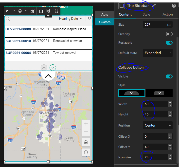

I'm trying to make the collapse button in a sidebar be more prominent. Is there a way to change the color of the collapse button or replace it with an image?

Thanks Dave. I did see those options. I was just wondering if there was a way to change the color of the button that I had missed.

TonghuiMing
@garmendariz Starting from AGOL 10.1 (dev1.8), the customization of the sidebar button has been provided:
Note that since this button is directional and needs to flip on action change, the OOTB-provided selection is limited and you could not replace it with an image.
