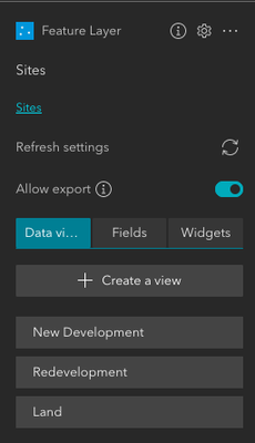

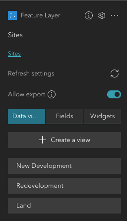

I found this post which was helpful in removing layers from the initial view. I also have 3 views setup filtering the data for a Feature Layer.
Is there a way to set the initial view for each page in a Multi-Page Experience without adding separate web-maps for each page EG on Page 1 I would like the initial map to be New Development View, on Page 2  Redevelopment View  and on Page 3 Land View?
