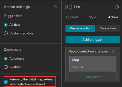

Hi all,
Following the November 2024 ArcGIS Online update, we have provided an option to return to the map default extent after de-selecting a feature.
You could select message action -> record selection changes -> Map -> Zoom to/Pan to, then check the "Return to the initial map extent when selection is cleared" option.
Thanks,
