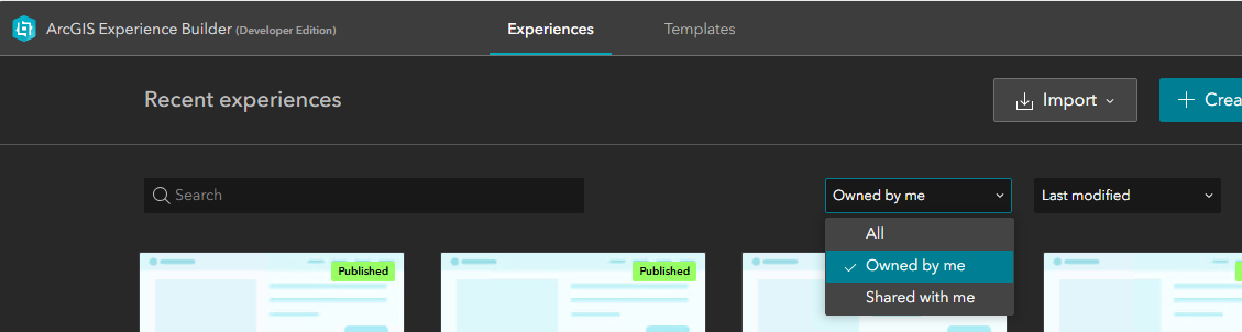

Followed the instructions for "upgrading" Exp Builder Dev edition - copied all the server/public/apps over from 1.18 directory to 1.19 server directory. Can only see my (logged in admin user) applications. In version 1.18 there was option to view apps from other users. Anyone else seeing this issue?
Here is the homepage for version 1.18

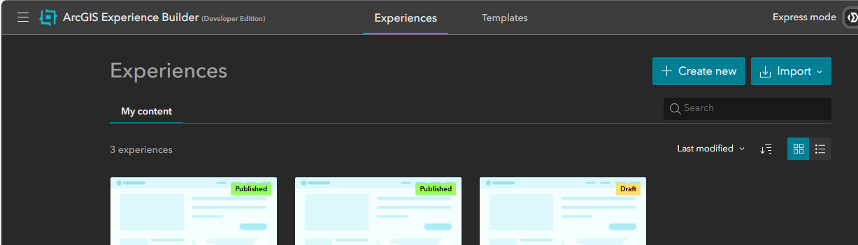

Here is the homepage for version 1.19 - no option to select other apps.JeffMertzXcel_1-1763914059955.png
Of course, there is a workaround to just change the URL to the app id, but seems like there's a bug in the homepage, since this is an app from another user and it works: https://blah.com:3001/builder/?id=22

Fortunately, didn't run into that issue, well, at least for the 2 that I tried. Haven't tried import, as copying over into /server/public/apps seemed to work. No custom widgets here, all OOTB.
KoltWright
I am experiencing the same issue. I had to revert back to 1.18 to be able to view everything.
JeffMertzXcel
I currently have one ticket open with support for 1.19, will add another one for this issue.
