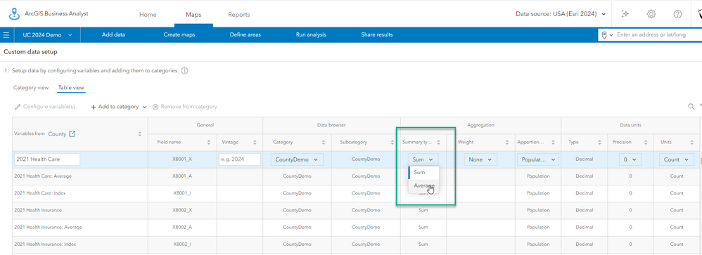

If you are using variables from your custom data setup in the infographic, please note that the two data summary options available are "Sum" and "Average" as shown below:
