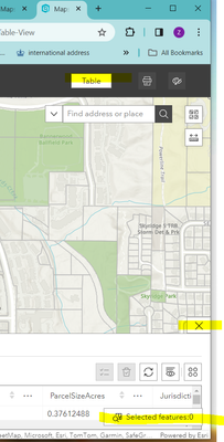

I got it working with the transparent view idea. Not bad, but a couple minor issues at least the way I did it. Just a prototype so not really styling it nicely (I'd probably have the button look similar to the widgets with just an icon). I added the close button, but couldn't figure a way to have it sit directly in the table widget, so it's kind of awkwardly above it. And my section is in a sidebar with a map which seems to cause the embedded map widgets like 'Select' to display above the view. See screenshot.
