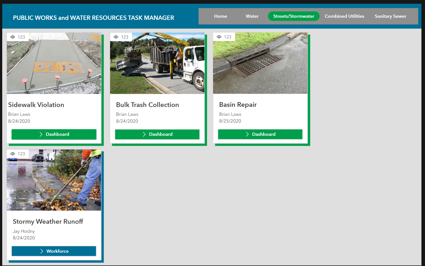

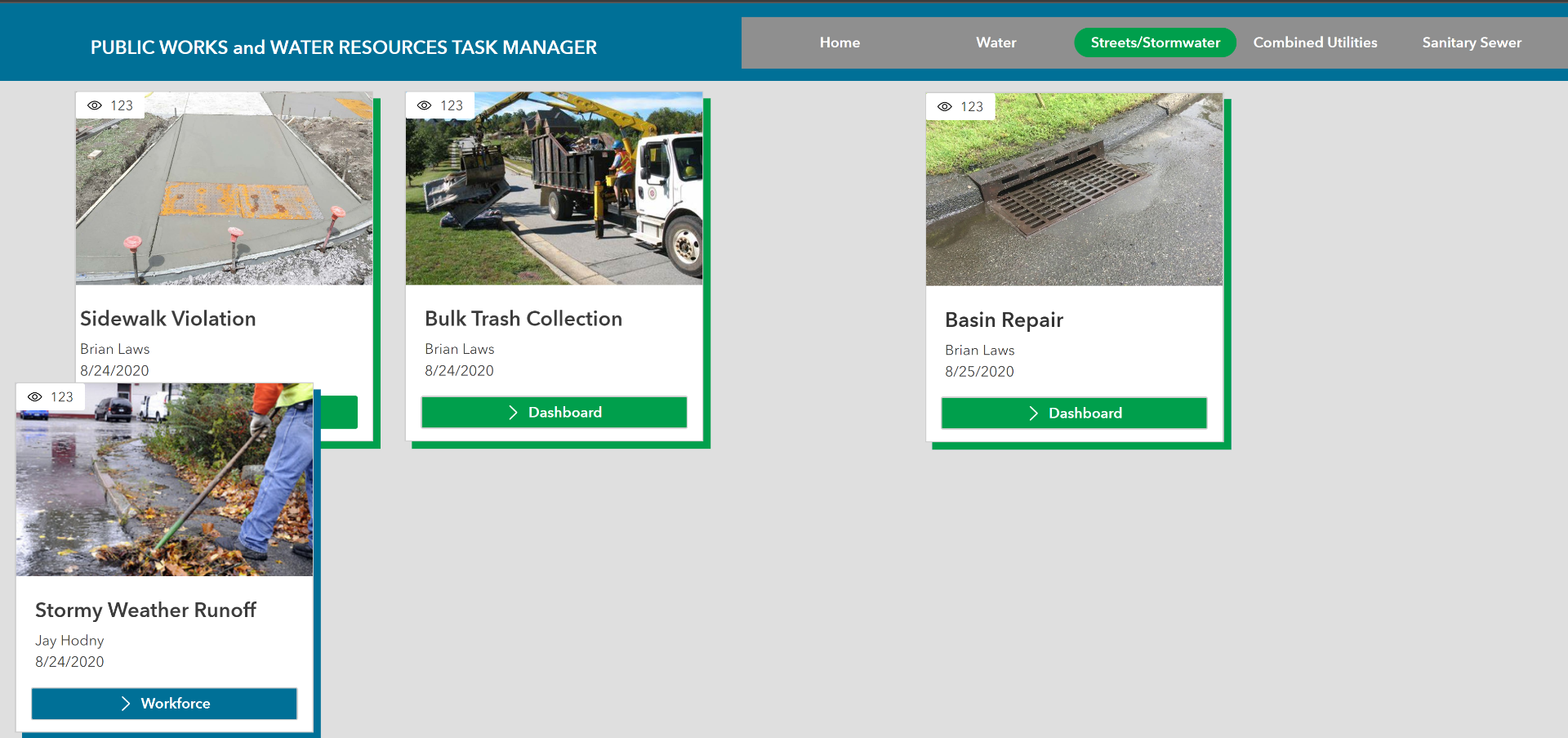

I am working with ArcGIS Experience Builder as a newbie.  I have created a multipage experience, with each page (except the homepage) having one or more card widgets.  The placement of the cards in the builder pane is my desired goal, yet the published version for the user shows the cards in different and overlapping positions.  Why?  Screenshots below.

What screen size (e.g., 1280 x 1024) are you viewing it inside the builder? If you switch between the different sizes do the positions change for the cards? Based on your screenshot it looks like you're using percentages for the cards. If they are using % under style then they will adjust based on the screen size.  Are the cards in a container such as a row? If not, I would add a row to control the placement of these, or you can always use px for absolute positions.

Both screen shots came from my laptop screen, same resolution and all that.

Hi Dave!  Thanks for the ideas to try.  The cards are in a "row," but not in the row container.  I will try that, and toy with the resolution, and px rather than percentages.  I will reply with any success, or not.  Many thanks, Jay
