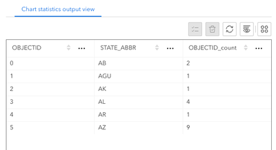

1. Add a Chart widget to calculate the statistics. Use the chart output data as the data source of the table sheets.

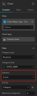

  • Add a chart and select Statistics as Count
  • Create a new sheet in the Table widget, and select Chart statistics output view
It will give you a table of counts from selected categories in the Chart widget. But the field name cannot be customized and it can only show one field count in each sheet.

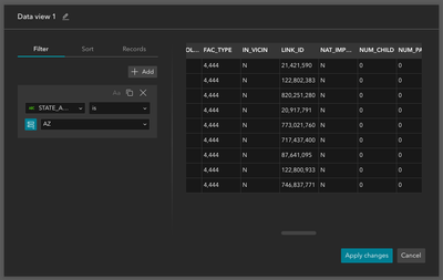

2. Create data views with predefined filters and use Dynamic content in the Text widget.
  • Go to the data you would like to calculate statistics and create separate data viewsScreenshot 2023-10-07 at 17.58.28.png
  • Add Text widgets and connect to the data views
  • Use Dynamic content to calculate the count
