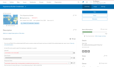

When you setup your experience builder for this did you create an application, setup a client ID
Like in this screen shot?
If so did you click manage, and ensure the host URL under application is correcft and that you have redirect URLs setup (It may look like this:
If you have, then the only other thought I have is that your Administrator may need to do something to enable CORS for your domain where the experience is hosted.

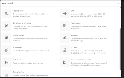

How did you create the experience? Did you go to New App > Create Experience? (this creates it inside of your instance, and is not like a local dev or hosted experience IIRC)
The other is to go to new item
You can create an application there, and you can also setup API Key and OAuth 2.0 Credentials for custom applications.
I'm not sure which you may need most.
