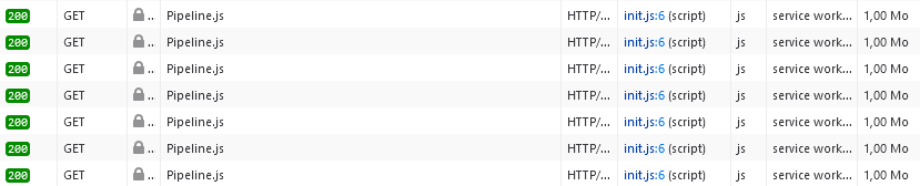

One thing we have found is that some ressources from the API are loaded multiple times without using the cache.
For instance, the 1Mo file Pipeline.js is loaded 7 times from the API.
Is not the only file downloaded multiple times.
Do you have any ideas to solve this problem ? Maybe it's a bug...

The file is used by multiple webworker, but the file will be downloaded only once.
