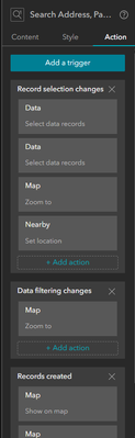

JudithWammack
@DavidColey
These are my actions right now. I have it where when you search an address it will select a parcel that is associated with that address.
I have another one where if you search a subdivision name it will select all the parcels that is associated with that subdivision name.

Yeah @JudithWammack - these interactions get tricky what with having to mix locator and layer sources, and then the actions to feed NearBy's and / routing.- which I have as well, just in other ExB. I'm having to go through all of them....But that looks right to me.
