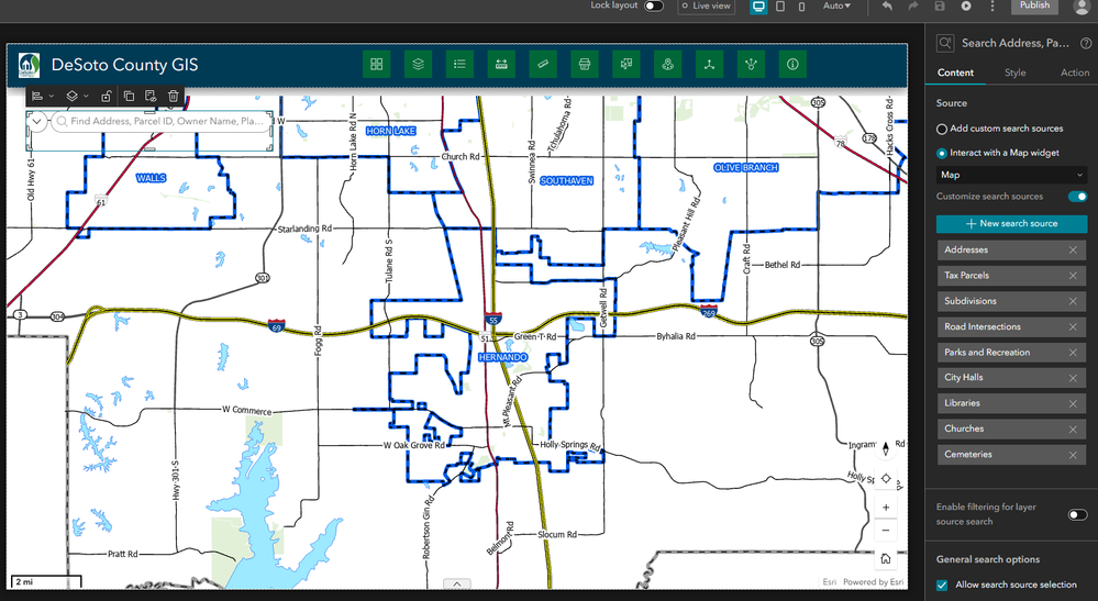

JudithWammack
@DavidColey mine are set to interact with a map widget. We need to keep it like that because we are using URL Parameters. This is the only way we could get them correct.Screenshot 2025-10-23 141131.png
MathiasHudock
This helped in my case; I was able to switch from "Add custom search sources" to "Interact with a Map widget", and then use the "Custom search sources" option to add the same sources my organization was previously using. Search bars worked fine after that.
