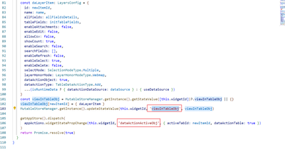

Hi SerjStol, you can try updating the table widget's mutableStoreValue "viewInTableObj" and widgetStateProp "dataActionActiveObj" like the add-to-table action. The table widget will do the rest.
The first one will add the data to the table. The second one will open the data's tab.
SerjStol
Thanks @Allen_Zhang , I will try it, currently managed to get Table Widget Id programatically, next i need to make data sources from the non spatial tables I think, then try use your code to add them to table.
