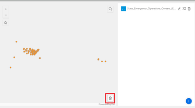

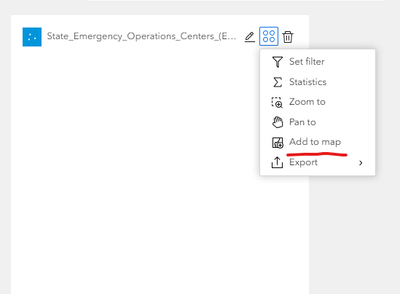

You can use the 'Add to Map' data action to achieve your intended goal. Notably, you can always remove the added layer by clicking the 'Clear Results' button at the bottom right of the Map.
