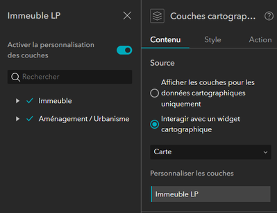

And I think I misspoke about the functionnality of show/hide. I want to create my own script to separate in several Features List all layers of my WebMap. By this, I need to know what is the correct library to create the check-box to allow the user to show/hide one of the feature layer. (If it possible...)
With the ListMode it make it able or not to show the layer in the list.

Not exactly. The purpose of useState() is to preserve values through React re-renders. React components are re-rendering all the time because something higher up the React tree is updating and anytime a component calls setState(), it forces a re-render of that component. Add console.log('re-render') on the line under const Widget and see how often it actually happens.
If you want to use multiple Map Layers widgets that can all be customized, that functionality has now been added to the ArcGIS Online version. It will be available in Developer Edition 1.13 which will be released in November or December, so I suggest just waiting for the update to be released. https://www.esri.com/arcgis-blog/products/experience-builder/announcements/whats-new-in-arcgis-exper...
The listMode property does allow layers to be hidden/un-hidden in the Map Layers widget if you need to change this property at runtime.
GIS Developer
City of Arlington, Texas
JasonBOCQUET
Ok ! I think I have understand. I need to practice more to be better on javascript but I have a short time to make my application. It's hard ^^
For the update on the Map Layer widget. It seems to be an upgrade of the "group" layer and it's only in one pop-up box ? I try to see in ArcGOL but I don't get the difference, it's the same option that I have in Exp Builder
With this fonctionnality in 1.12 I can choice which layer have to be show/hide. In 1.13 it's possible to do this but a multiple time ?

In 1.12, you can customize your Map Layer widget so you can decide which layers to show, but if you try to add a second Map Layer widget, you will see an error saying it cannot be customized.
In 1.13, you can add as many Map Layer widgets as you like and customize them all.

All right ! It will be good for my project to create many buttons with certain layers of functionality grouped by theme.
Let's go learn Javascript as fast as possible and wait for the 1.13 update in dev edition.
