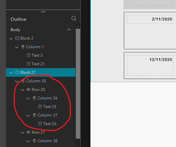

So far, Experience Builder has been great - but there is one enhancement that would help a lot.
Could we get the ability to duplicate elements?
In the example below I have configured the heights, spacing, backgrounds, etc. for the Column and child rows and I want to have the same settings for a column element below it. It would be a great feature if a user could simply 'select' a group of elements and then duplicate or copy it.
