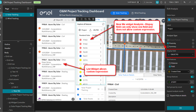

Well it's sort of there - but there is no way I can see to add an expression so the Display field can be used to show more information like in the Info Summary widget - it only lets you select one field for the Display so that's not very helpful.
If the Display field properties for the Analysis in the Near Me widget could be modified to include a custom expression then the functionality would be similar. The way it is right now is not ideal.
