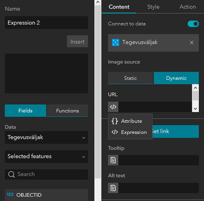

Can you share an example with us that shows how to do it? Under image settings, I can see options URL and expression but can't find a way where or how to connect it to the feature class or table's attachment table that holds the images.
Form Image widget the options display looks like this:

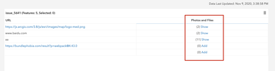

Hi,
The option is only available when the data source you set in Image widget has attachments. You can check on its item detail page.

DavidMurray_ODWC
There is a way.  It's not any fun, but you can do it.
If you have more than one image attached to a feature, the current options for selecting a particular one are not exactly straightforward.
Pre-published Dataset Instructions:

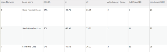

  1. Create a number field in your feature class dataset.
  2. Calculate the value using the Arcade function Attachments(), the value in question being the Attachment ID of your attached image.  (The Attachments function doesn't work in Online/published datasets.)
Published Dataset Instructions:
509369_pastedImage_1.pngTaking your original image from earlier in the thread, this is exactly the location where the rest happens.
The horrible part about this is that 'cut + paste' doesn't work in the Expression box <far left>.  You must type it all in.
Don't make the same mistake as I! Type the Quotation Marks First!  ...or you'll have to do it all over again...

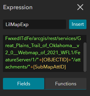

"Rest Service Address for the Feature Layer"+{OBJECTID}+"/attachments/"+{calculatedAttachmentID}
I'm adding a screenshot of my own little Attachment Expression <below>.  It so happens that each of my features has 2 attachments: one photograph to act as a regional summary, and one small map of the region.  This expression causes the display of the little map (thus the name LilMapExp).
The box can't be resized, so the first part of my feature location was cut off; also, when typing out your service location, paste it into a word document and change the font to something with serifs (that "l" on the first visible line is actually an "I").The box can't be resized, so the first part of my feature location was cut off; also, when typing out your service location, paste it into a word document and change the font to something with serifs (that "l" on the first visible line is actually an "I").
Excerpt of Feature Class Table, showing custom fields: Attachment Count, IDs of AttachmentsExcerpt of Feature Class Table, showing custom fields: Attachment Count, IDs of Attachments
