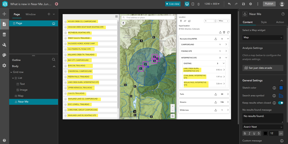

Show multiple field values as feature title
You can now show multiple field values as feature title.This is also Web AppBuilder parity functionality. Now with arcade support in experience builder, we can do so by creating a calculated field using arcade. In the screenshot below I added a new field and calculated it using simple concatenate arcade function, then used that field as display field in Near Me

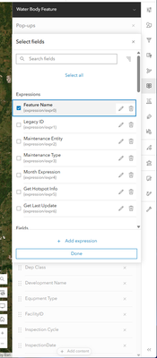

Hi @AzizaParveen1  - not sure how I can be more clear.
I was hoping to see that the Arcade enhancement that meant that widgets such as Near Me, Table or List would be able to read in an Arcade-generated attribute column from a feature layer within the webmap.
For example, when we set up an Arcade attribute expression for the popup, that expression is able to be added to the Fields view element for the popup, same as any other attribute.  It just appears as an expression column that can be added to the Fields list view:
This would mean that the widget would have to honor arcade attribute expressions that have been saved as part of a feature layer.  Then, for example, that attribute expression could be used as a source for the 'Display Field' in the Near Me, or appear as field that could be added to the Table widget.

@DavidColey My apology for asking to you to repeat, since I already mentioned in my post (the 2nd enhancement),  I wanted to be super clear that I am not missing anything🙂This is already possible in Near Me, and I am pretty sure  other widgets support this as well. Infact , the second enhancement I talked about in my post shows the same functionality, I used a calculated field (output of a arcade expression) and used as display field for showing as feature title.

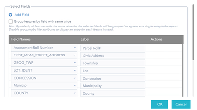

In Web Appbuilder, we were able to select which fields would be shown in the results and change the label of the field.  This is something we use quite a bit and I don't think is currently possible with the Near Me widget in Experience Builder.  Any possibility this functionality will be added in the future?  In the example below, a subset of the original fields in the layer have been selected to display in the results of the Analysis in the screening widget.

DavidColey
MVP Frequent Contributor
Yes - this is what I was trying to describe @AzizaParveen1 - The simple Arcade expression I have in my map works as I described above and as @RSL is describing here.  All I have done is take an existing attribute field that stores a feature Name in ALLCAPS and converts it to Proper case.
But it doesn't matter if I save the layer with the expression in the field list, re-save the map, and refresh the experience in edit mode, the expression attribute does not appear as field in either the data view or as an option to use as the display field.
I have a more complicated use case where I want to use a related field as the display by brining in the attribute from a related table with the Arcade function FeatureSetByRelationshipName, and use that as my display field.
But if even the simple case doesn't work, this won't either.
Thanks-
David
AzizaParveen1
Hi @RSL ,
Experience Builder does not support Arcade fields in the field list at this moment. The arcade expression in the pop-up profile supports more variables than ExB. Besides, using these Arcade fields in lists or other widgets can create performance issues, however it is in Experience Builder's future product plan.
In my example here, I created a attribute field first, then used arcade expression to calculate its value.
