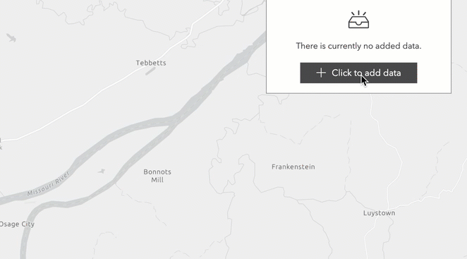

The Add Data widget, one of mostly asked widgets in the community, has been added in this ArcGIS Online release. In addition, you now can choose which layers display in the Map Layers widget like you did in Web AppBuilder's Layer List widget. Check the ArcGIS Blog post for more improvements on Business Analyst, Elevation Profile, Chart, 3D Toolbox, Grid, and Templates. Cheers

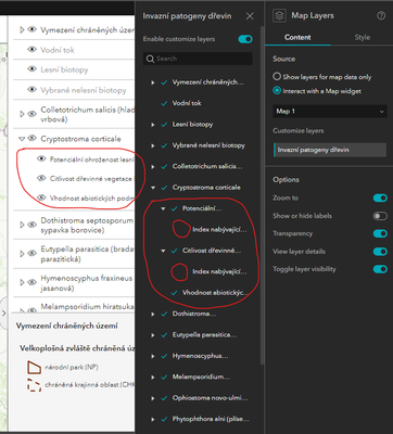

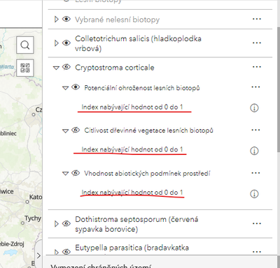

Hello,
I want to report a bug in recently added function "Customize Layers". It simply does not work as designed. For example in our app I want to hide text "Index nabývající hodnot 0 až 1" under every layer, but I am unable to achieve that. I unchecked them in ExB editor, however in Preview they remains visible. In Live view it sometimes works good, sometimes does not. In Preview and published result it is always wrong.
Can it please be corrected? Thanks
editor:
Preview / published item:

@DavidOutrata The May Layers issue mentioned above has been fixed. You can try it again.
Note two things:
1. If you have already created a widget with this feature, you might see some issues. The solution is to create a new widget and start from scratch;
2. There might be certain layers that will not show in settings, but at runtime, for example:
This is because, in map layers, we do not support the raster layer type currently.

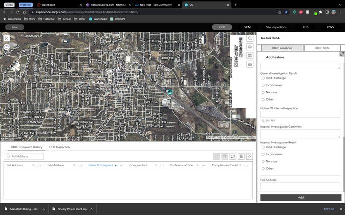

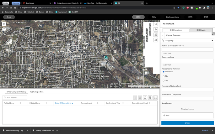

BlairMcclenathan
In regards to the edit widget: I'm having an issue where attachments are not able to be added to a feature table when editing through the widget. Is this intentional? I could have sworn this was possible previously.Point FeaturePoint FeatureTableTable

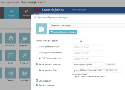

HennieDeurhof
Will the option to refer to a group in the Add Data widget be implemented?
That is essential for our use of the widget, this way we provide a currated list of layers for the general public.

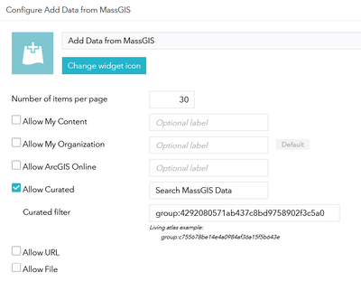

Hi @Jianxia -
I was very excited to see the Add Data widget is finally available within Experience Builder. This has allowed me to begin the migration of a public Web App Builder app into Experience Builder (this widget is critical to app functionality). However, I noticed that "curated content" was missing from the ExB version of “Add Data” widget.
In WAB I can do this:
I would really like to be able to do this in ExB but do not see how it is possible. For public-facing applications, this is a powerful way to steer users towards authoritative content. In the new Add Data widget with Experience Builder, I do not think a member of the public would have an easy time finding or adding authoritative data into the map. IMO allowing for curated content will result in a much better user experience.
Is there a timeline for when we can expect this functionality to be added?
